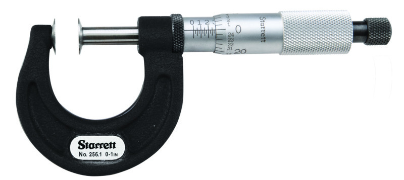

256.1 Mechanical Disc Micrometers
Featuring a rigid one-piece frame of drop forged steel and one-piece spindle (the heart of our accuracy), the 256.1 Disc Micrometer is extremely hard and stable. With quick and easy adjustment, the  tool is accurate to ±.00015" or ± 0.003mm measuring over the whole surface and ±.0002" or  ±0.004mm measuring on the edges.

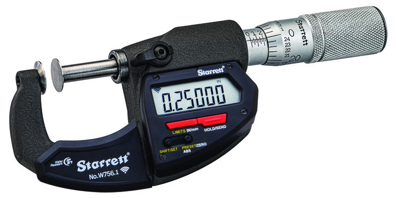

756.1 Electronic Disc Micrometers
The Starrett W756.1 Series Wireless Disc-Type Micrometer with Rotating Spindle with Output is a full-featured precision measuring tool built with customary Starrett quality and workmanship. With an accuracy of  0.00015"in measuring over the whole surface, Starrett electronic micrometers guarantee a precise measurement at every position each and every time. Available with built-in wireless.
