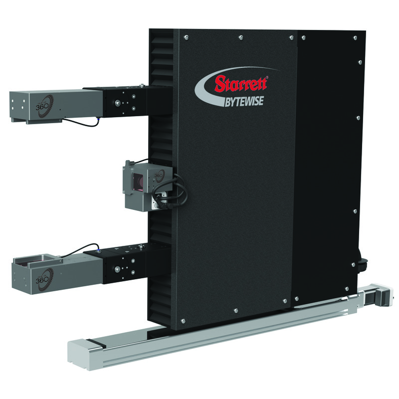

GEO-360 is a tire geometry measurement system for retrofit to tire uniformity machines and balancers. It has a rack and pinion drive system that can easily be customized for travel and height. Sensors are mounted on pivoting break-away hinges secured with ball detents.  An air blow-off system reduces contamination on the sensor glass.
Measurement Parameters
  • RRO and LRO
    • Peak-to-Peak
    • Composite
    • Harmonics 1 to 32 with angles
  • Bulge and Depression – magnitude and angle top and bottom
  • Wobble
  • Section Width
  • Tread Local RRO
  • Open Cap Splice
  • Circumference for each rib
