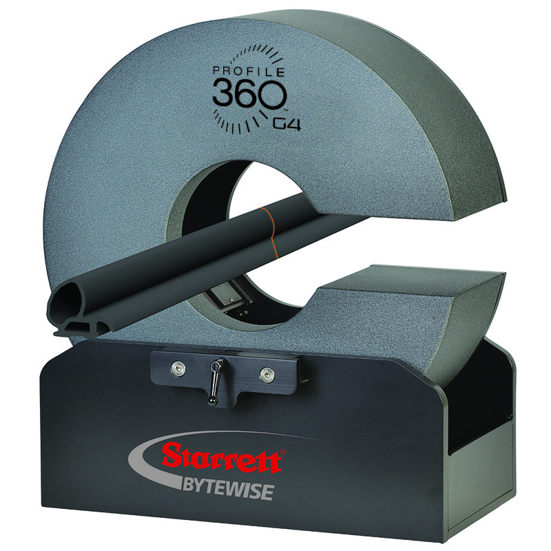

Profile360™ continuously monitors the size and shape of complex profiles in order to assure quality and avoid the high cost of defects. The system acquires thousands of data points around the profile and matches them to a CAD template, where key measurement parameters such as width, thickness, gap, radius, and angle are extracted. Measurement parameters are compared to allowable control limits and displayed on the operator's terminal with a pass/caution/fail status indicator. Profile360™ runs at rates up to 20 profiles per second. The system is available in standard sizes and can be custom-built for almost any size and shape.

Inspecting with the Profile360™
- Line Operators can immediately observe and react to manufacturing problems
- Production Managers can quickly review historical run data
- Quality Control Managers can better understand the process and factors that cause variation
Additional Benefits Include
- Faster startups, faster product development, faster die design
- Improve customer satisfaction
- Reduce inspection labor and material scrap
