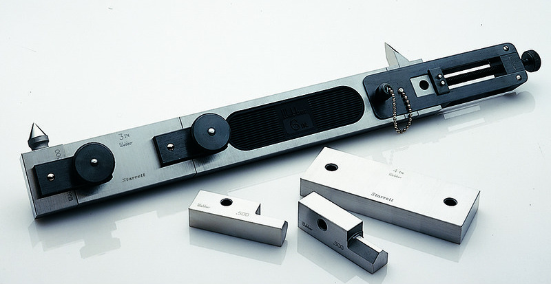

These heavy-duty gage block sets are primarily used for assembling together into exclusive Webber fixtures.

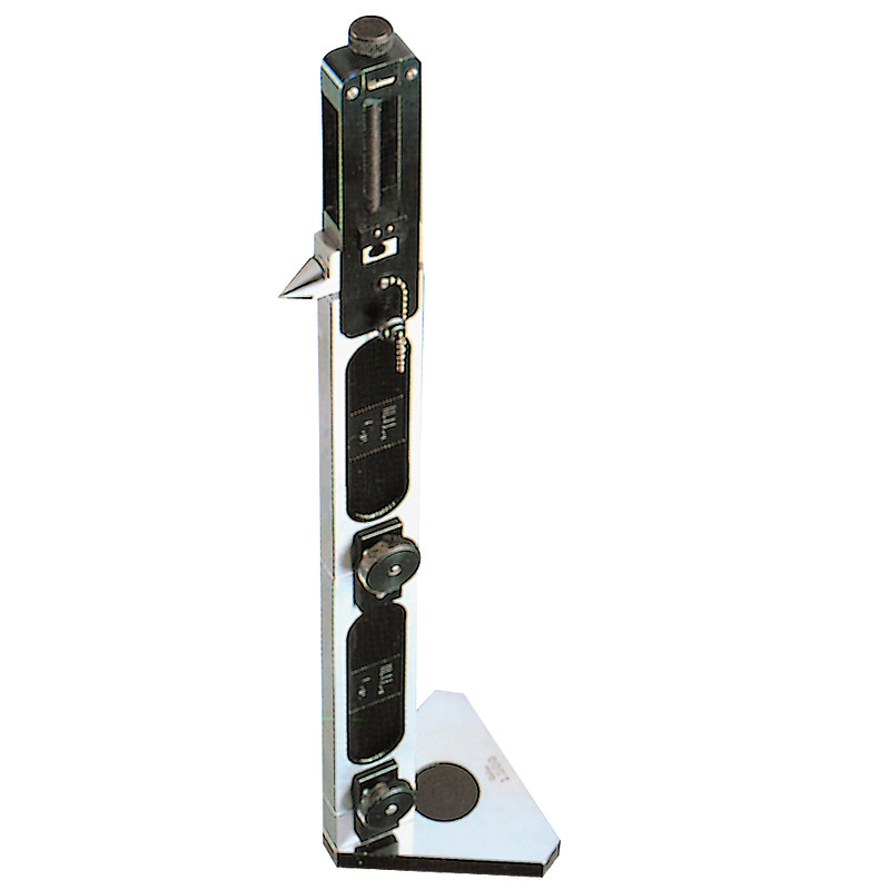

Precision "yardsticks" and height gages can be built up to a required dimension by wringing blocks together and then by the use of eccentric clamps, locking them into place. All blocks over 1" long have 1/4" holes that accept eccentric clamps. All blocks 6" or larger have an insulated center grip to eliminate temperature variations caused by handling.
Precision scribers and  dividers for tool layout can be created in a few seconds. The center point is on a .500" center line of a 1" block. The  scriber point may be sharpened indefinitely without altering the original accuracy.

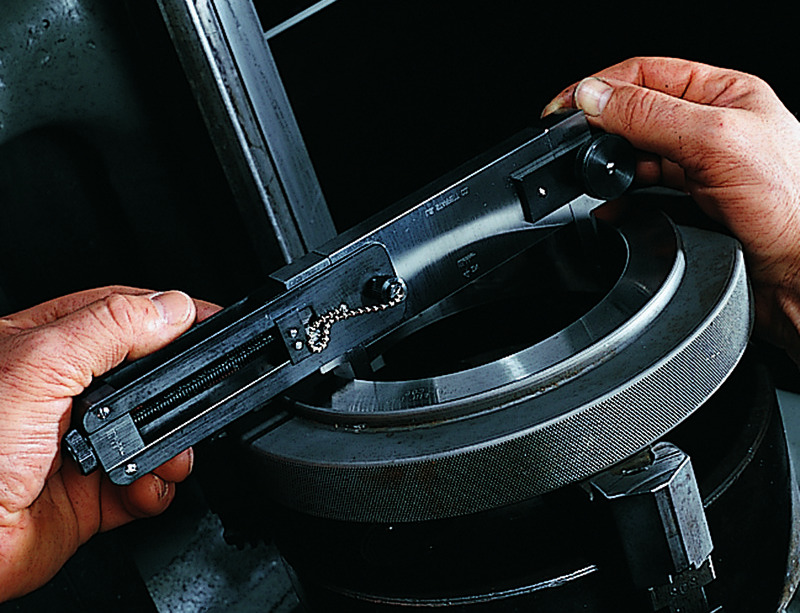

Snap gages with inside or outside  calipers can be easily assembled using accessories like the eccentric clamps, a quick-acting clamp, and a pair of half-round or straight jaws.

Building up blocks into precision "yardsticks"

Snap gage is used to check inside dimensions of ring gage still mounted in internal grinder
